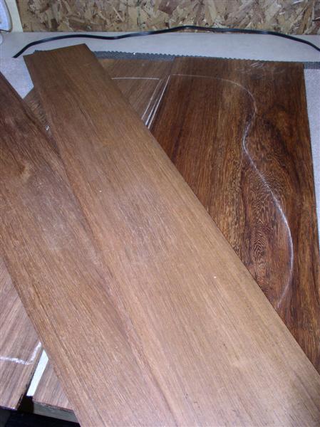

Check the OLF auction tomorrow for this set of Madagascar Rosewood donated by Brian Hawkins (BeachTonewood)

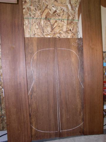

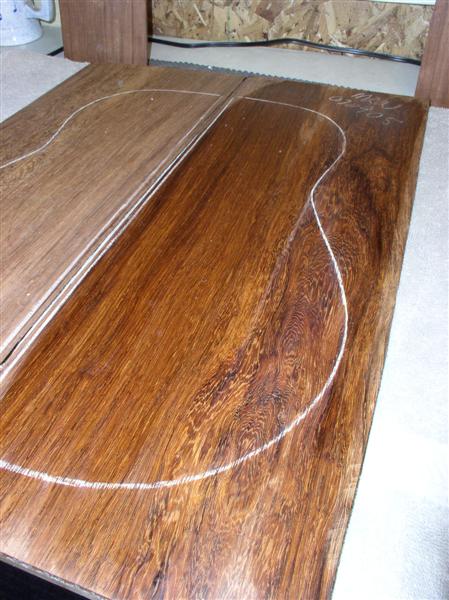

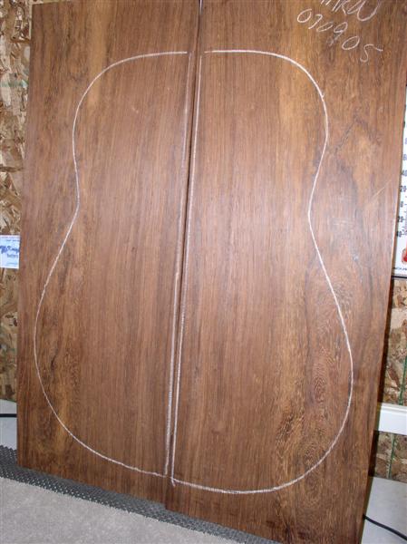

The auction is up and here are a few more images of the offered set!

All quartersawn?

Hey Guys,
The sides are Q/S if my fading memory serves me, and the backs.....MRW is a very small tree and it is fairly uncommon to find full Q/S backs. Almost always you will be getting flitch cut 4 pc. backs that have been joined to form two bookmatcked peices.
